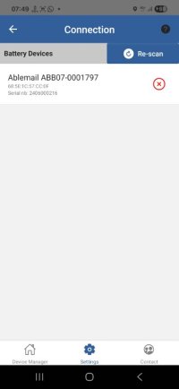

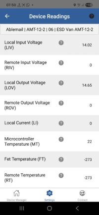

I must have read that 100 times and the reprogramming bit still foxes me!
Get the BT module....
Then you can watch it working....
And play with the settings.
The app shows when the charge pulses are on, same as the LED on the unit.

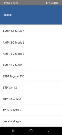

Just asking for a friend here, but can you change the cut off voltage on the LB on the BT module? Setting 4 works great, but that pesky 13v! Fridge comes on, LB volts go down below 13v, no AMT, I'd be buggered if the sun didn't come up!
I would love to reduce the 13v cutoff to something less so the AMT works through the night.
You can change all of the settings individually as well as choosing a preset.

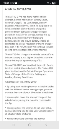

Yes... What price are they these days?
Have you seen the new version with built in BT?
Amt12pro.
Looks like same thing but with built in BT?
