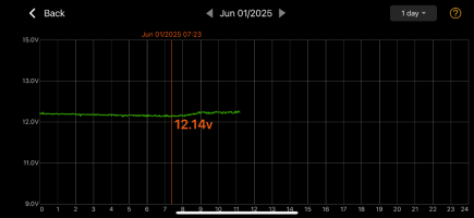

From the smart shunt (upturn is sun hitting the solar panel):

From the BMT12 battery monitor.
If the Ablemail was working surely it wouldn't let the starter drop to 12.08V?

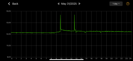

Latest from the smartshunt, can't see anything that looks like a blip from the AMT:
Having run the van the SB over the course of a couple of days reduces from 12.5+ to 12.3v. When at and under 12.3v, On the Cerbo's Remote console you can see the voltage tickle up and down between 12.7 and 13.1v.

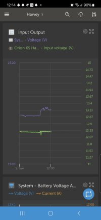

The input/output widget is useful, but you can still see the data on the 'dashboard' and 'advanced' pages of the Cerbo app.
I'll add a screen grab off my phone shortly...

You can see the LB voltage (purple) shoot up when the sun clears the houses opposite.
LB was on 12.93 until then, SB on 12.24v, now tickling between 12.7 and 13.2, you can watch it move up and down on the remote console.

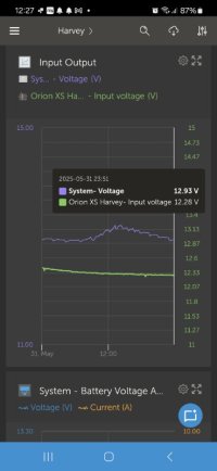

SB was on 12.93 until then, now tickling between 12.7 and 13.2, you can watch it move up and down on the remote console.
You can also see the SB (green)reduce when I opened the backdoor to take a photo of where I store my F45s winder for a member earlier.
It's a handy plot to have SB and LB on the same graph with the same 'Y' axis, 11-15v, which both batteries fall within.
This was yesterday's plot, at the end of the day the LB was under 13v and the Ablemail went to sleep for the darkness hours.

It does make you wonder where the figures come from! I wonder what part your Ablemail is taking its info from. According to the SmartShunt the Ablemail shouldn't be kicking in (It's over 12.3v), but the Orion says it should! (That's under 12.3v)
Ok. From the SmartShunt and the XS. From local BT.
