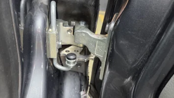

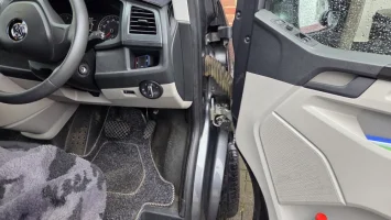

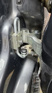

The springy steel “S” shaped thing built into the hinge and holds the door at different degrees of open has fractured. Can the be bought/replaced separately or is it a whole new hinge job?IMG_3538.webp
The whole bit needs changing.
They call it a check strap.
Just had both mine done....
