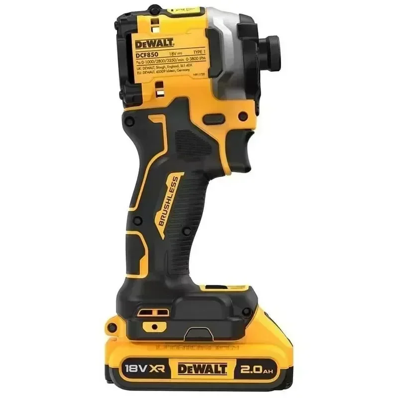

I’m a joiner and use dewalt tools.
I recently ordered a few Chinese copy dewalt tools and batteries from AliExpress.
They are decent and I am impressed with them considering the price.
I ordered the tiny wee impact driver to see what like also and it’s good.
Is it going to last as long as a real dewalt who knows I doubt it but for £27 I’m sure I will get my money out of it.
This is it here for £18
You will need a battery and charger also
I just found this on AliExpress: | DEWALT DCF850 Impact Driver Electric Driver 20V Lithium Battery Brushless battery screwdrivers High Torque tools 공구
