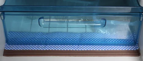

My CRX50 has a drain plug which isn't connected to a tube. Some water does manage to collect in the bottom but I've now learnt to deal with it. When we first noticed it a few years ago, it proved to be a pain in the aris when we were parked up on a pitch with a very slight slope down to the passenger side and water ran out of the bottom of the fridge and under the mat. We only saw it on taking the mat out to give it a shake (sand!) - luckily it couldn't soak through the flooring so no real harm done but things might have got smelly had we not found it. My solution which is now tried and tested was to put a strip of rubber draught excluder across the width and slide a folded J Cloth (or at least the Lidl version) under the door which fits perfectly and soaks up any water that gets to it. We keep another one handy in a drawer and swap them over every few days after giving the bottom of the fridge a wipe. My bottom line would be if you can manage the condensation there's really no need to drill another hole.
Actually, looking at the above picture again, I realise that it's actually two parallel strips of draught excluder.
