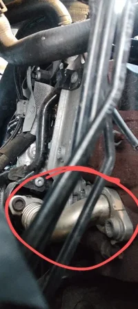

juggz Member VIP Member 3 Jul 2025 #1 Hi all. Got a hissing pipe ......ideas on what it is and where I can get a new one and any other bits needed for it. Ta
Dav-Tec Audio, Security, Brakes, Suspension & so much more VCDS User Trade Member T6 Legend 3 Jul 2025 #2 Ah. The old EGR pipe leaking there bud. You'll need a new one then break along the correlations bits. They're a bit of a fickle creature them buggers

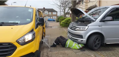

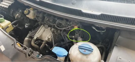

Dellmassive T32 204 DSG LWB SLN PV MY18 & T30 SWB KMB MY67 VCDS User Moderator VIP Member T6 Master 7 Jul 2025 #4 Post in thread 'EGR flexi-pipe: Exhaust Fumes In Cab, Hissing From Engine Bay.' 2 Apr 2021 mines just gone . . . well its been leaking for a while. MY18 204 DSG 36k miles. (within warranty - just) The AA guy failing to diagnose it. (VW Assist callout, asked for VW guy but got the yellow van guy =[ ) The VW assist correctly diagnosing it: (VW Assist callout) My pipe as is now. +++ +++ New one to be fitted in a couple of days hopefully. (VW Assist callout - return to fix with parts) . ill update when its done. Edit: He called this morning to say the local TPS was out of stock... part...
