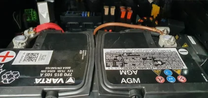

I have the factory starter battery and a factory leisure battery.

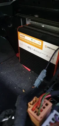

I have an aftermarket inverter (Mercury Soft Start Modified Sine Wave 600W 12V) under the driver's seat, disabled for power saving. The inverter supplies two mains sockets in the rear, these also have two USB sockets each. There is an aftermarket switch on the dash which disables these extra USB sockets (not sure why it doesn't also disable the mains sockets).

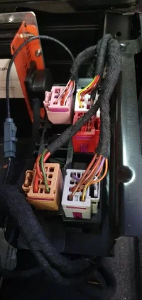

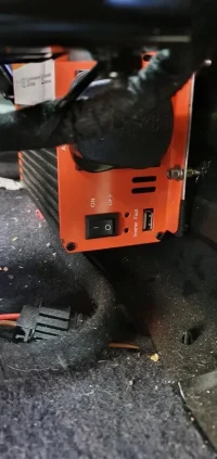

Under the driver's seat:
The second photo is something I'm curious about, what is it? And are all those plug modules of any interest for future options?

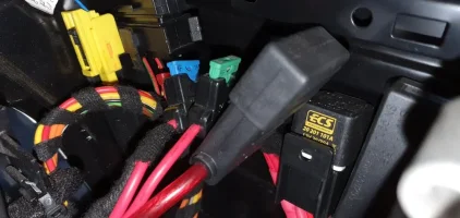

Under the passenger seat (I do have the rubber cover but removed it so I could see what battery I have (same as the starter):
The shiny white box in 1st photo looks like a little junction box, I don't like the look of the little module with the bare connector sticking up in the air.
The last photo is just a mass of red wires.
So, no idea if this is good, bad or indifferent. Interested in any feedback though.
