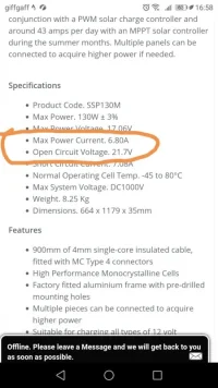

What is the spec of your solar panel. Is the open circuit voltage less than 23v?

Have you got a link to the panel you have fitted. We need to know the VOC

Your open circuit is under the max amount so that's good , as above states there shouldn't be eny flashing orange lights , also if your battery is fully charged then you should have a steady orange light on the A if your engine is running and a steady orange on the solar if there is sunlight and you battery light will stay off if fully charged as it will be in trickle mode
