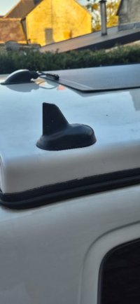

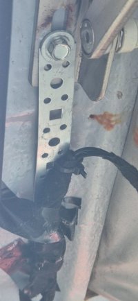

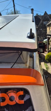

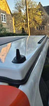

So.. have put up with rubbish DAB for 2 years since buying our T6 and installing a new kenwood head unit. Everyone said that DAB in VW vans is rubbish because of wing mirror aerial and the windscreen stick options don't work, especially with a heated screen. HOWEVER... this week I finished installing a shark fin to the the pop top and the radio reception is full on brilliant. Solution being using the roof hinges to get the earth to make the ground plane for the aerial. So... there is a solution and it does work brilliantly. There are one or two issues to overcome...notably the pop top is thicker than the aerial securing stub but there is a solution for that too...
