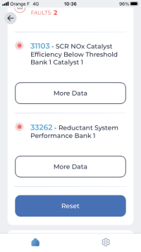

so I’m currently in France, had the warning twice now, both times it has reset itself which is lucky as I’m 500 miles from a ferry. The only error codes I had were below. I’ve read nearly all the posts on here about this issue, some have had new sensors or tanks but it doesn’t appear to solve the issue, others have tried to get software updates from VW with mixed results. My current software is 6163. I will be into VW Croydon on my return to see what they say but the problem seems to be there’s no one fix and can be an expensive business changing bits of the adblue/ emissions systems hoping it solves the problem. I don’t think this heat helps either, I wonder if the adblue is evaporating a bit changing the concentration. Be interested in your outcome
