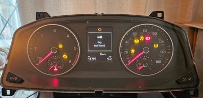

I managed to find a T6 colour cluster on eBay after a long period of searching. Unfortunately I didn't notice in the pictures what looks like a rusty water line at the bottom of the colour screen. D'oh!
I would've taken them apart and had a look inside but the part number acts as a security seal so can't break this and attempt a return if this is broken.
I know the cluster is basically the immobiliser and Component Protection "Master" module so want to check with experienced people before plugging it in. If I plugged it in and turned the key to position 2, would it disable all my modules that are Component Protection enabled because they aren't on the colour cluster's list? Would I get immobiliser issues if I didn't attempt a start?
The van is in a partially disabled state, the radio is removed and the front radar is brand new but has been plugged in and already shows CP active. The bumper is off so I can unplug it if required. Does anyone know which other modules are CP enabled?
The van is a 2018 T6 Highline with B&W clocks, new clocks are part number 7E0920980L, allegedly from a 2018 T6 but have a manufacturing date of 29.06.2015 so may have been retrofitted before.
