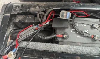

Any thoughts on the easiest way to get an ignition live feed to under my driver's seat?
I've read the post here -
www.t6forum.com
But not sure how to do so physically - My passenger seat is quite full with leisure battery, Dc-DC charger and diesel heater feed so not easy to move it for access.
Is it bad to run the D250SE without the smart alternator cable connected?
