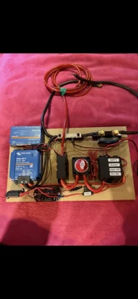

I fitted my shiny new Cerbo to the panel that’s going in beside my Roamer battery today.
I’ve taken the positive from it to the non fused side of my main power wire going to the LB. Same place as the shunts live goes to.
Is this the best place for it?
I also worked out where the screen is going and where I’m mounting the EcoFlow 800w charger and sub/amp.
I just need to order the 3 VE cables for the shunt, Orion and MPPT and the Roamer cable then get the finger out over the weekend.
