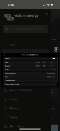

Is your Orion connected to the Cerbo?
Yes you can see it in that last pic I posted above custom widget.

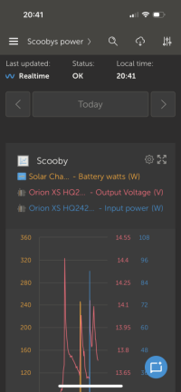

I can get in to make a widget ok and have set one up. But only seem to have my connected devices as options for the widgets.
One I’ve made has Orion input and output as well as MPPT input.
I would like one to show me my SB output and the AMT working
Here’s widget I've made

Once you let your van settle down, you'll see if the input voltage doesn't go below 12.3v, you've got input power Watts on yours. Here's mine from today, I haven't started the van since Tuesday so the starter needs it's fix from the AMT.

So the Orion input is my SB. Got it.
So is that blue spike on my widget the AMT?
I can’t seem to get the screen you got on your widget?
