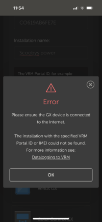

I can’t set up VRM and thats the problem.
I need the Cerbo connected to internet to add it to my installation device list to set up the VRM.

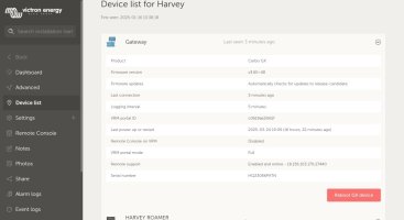

I’ve got it working thanks guys.
The problem wasn’t the WiFi it was VRM code. I put a O instead of an 0.
Everything seems to be working. :geek:
