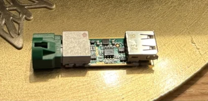

Hi all, I’m looking to enable Apple CarPlay via App Connect on my 66 plate T6. I get that we need to do this via the dealer or a 3rd party SD card, but I also understand we need a ‘special’ USB port in the first instance. I’m fairly sure I have it already, but just to confirm, does this look right to you? I think the pins are bent or even missing.

Thanks Cnud. I've sourced a replacement (as pictured) as mine was damaged as I suspected, but extracting the mounting plate out of the dash is proving to be a pain in the... Is it just a case of persevering with the pry tools until it pops out? There's really nothing online on how to remove it.

To remove the dash mounted USB socket shown in the first pic you'll need to access the back of the trim panel either by removing the glovebox to access from above or the lower glovebox to access from below. There are plastic retaining tabs top & bottom that clip it in place which a trim tool may not reach to as they're quite set back.

Legend! Thank you. I removed the lower glove box and found it a fairly straight forward job. Reaching the back of the USB housing was a bit tricky as I didn’t quite have the reach. I did though, manage to feel my way to the back of the USB harness and push on that. It doesn’t take too much force to pop the housing out. Swapped out the USB and I was able to set up CarPlay via SD Card. It’s all good so far.
