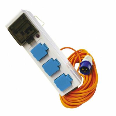

I have an EHU which comes in next to the vehicle battery, and initially bought a small fuse box but then found this inline RCD:
This has a thick three core which I routed via a plastic gland through the firewall into the passenger side cabin, and then down the wheel arch, under the carpet and over to a 2 x 3 pin female outlet under the driver's seat.
