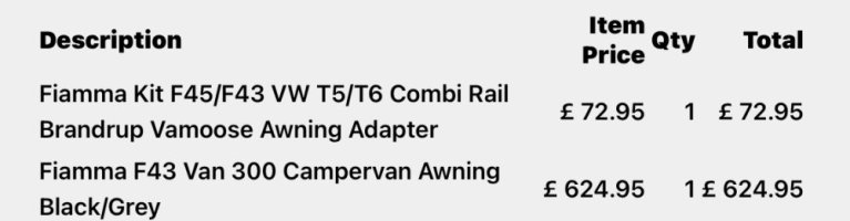

That's good news that it doesn't add to the height of the van. I have a Remio pop top and Remio multi rail so should look something like yours. Thanks for your reply, would you recommend the f43.

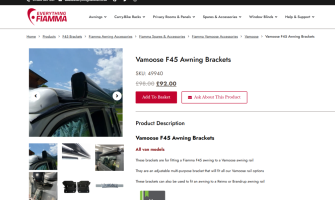

Could I ask what brackets you fitted in the end, was it 98655z156 or 98655z147. As I have a Remio rail and purchased the 98655z156 brackets and the rear bracket is to long and over hangs the rain channel on the van roof, the front bracket seems to fit perfectly. Trying to fit my newly purchased f43.
