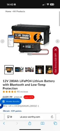

But basically I’d like tk change the battery to a lijtium
One and therefore I assume update the dc charger and battery charger etc at the same time .
I’ve had my eye on some ecoworthy stuff
And wondered if this would still suit .
All help appreciated
Thank you
Initially I was however will
Depend on the size of the battery
Assume that’s what you may have meant ?
Yea mate under the seat will be limited by space , there are big battery’s available that fit but not much room for anything else. Look for seatbase battery’s from roamer / fogstar.
I think with that particular battery under the seat would be impossible. I did look myself at that battery as thought a good price and if I remember correctly it's quite a large size
Yeah this is my initial, tbh I’m happy to relocate or also reading it can be mounted on its side if it’s. Life po4 one .
