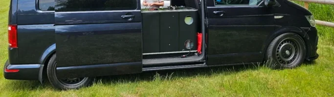

I've got the vangear kitchen pod which is removeable and the OEM factory heating coming out the B pillar. I use a fire blanket to direct the heat into the cab so it doesnt melt the pod.
