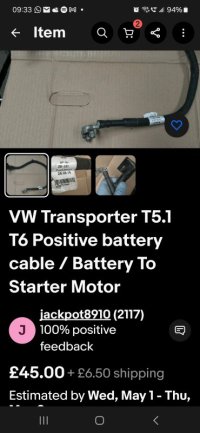

The Lug has sheared the pos bolt, so I can't put it all back together...
The Lug is part of the main harness so I can't even just replace the Lug...

You can replace the cable with a OEM new or second hand one would be best.
Or bush fix with a new battery terminal and lug.... But it's needs to be done properly.
Or maybe drill out the snapped stud and captive nut and fit a bolt and nylock nut?
Ah.... That unfortunate.

Any tips on replacing the cable... Other end etc...

The other end of that cable is the main POS connection for the starter or alternator, can say exactly which without double checking.
Not sure the AA would entertain that, unless you had a replacement cable and nice cup of tea and biscuits as a sweetener.
In sure a new OEM cable would be well pricey.
Suppose we can look to get a part number for it?

And looking at this end of that cable I'd say that's the starter cable...
