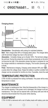

Cnud Member VIP Member T6 Pro 23 Feb 2022 #1 Does this charging cycle look right? I assumed desulfation happened at the start. Been on charge for a couple of days with an old Ctek XS 800 TIA
Dellmassive T32 204 DSG LWB SLN PV MY18 & T30 SWB KMB MY67 VCDS User Moderator VIP Member T6 Master 23 Feb 2022 #2 According to the xs800 pdf. It's in pulse stage .... So yes, for that charger it's normal. https://www.google.com/url?sa=t&source=web&rct=j&url=https://docs.rs-online.com/3cc5/0900766b813d8f11.pdf&ved=2ahUKEwini5HjzJb2AhUSolwKHZxMDXYQFnoECA4QAQ&usg=AOvVaw2y8s0JBbOIz_FGSQPhR5vV .
