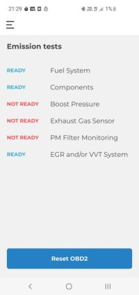

I noticed this today on the carista and my friends vag com came up with it too. This was just with the ignition on. Everything else looked fine on the vag com.
What do you think?
