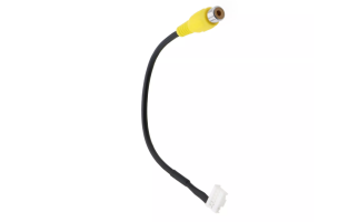

I've just bought an Alpine Halo 9 (ILX-F903D) second hand and wondering what I need to do/purchase to utilise the OEM Reversing camera?

all you need is a simple adapter that plugs into the quadlock plug, stock item
