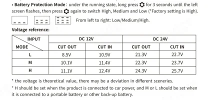

I have a new AlpicoolCRX 50 and I was having the exact same problem as many on here - freezer getting very cold, but fridge only going down to max 7 degrees. I seem to have fixed the issue i was having by adjusting the battery protection to low. I think the fridge was incorrectly sensing a low leisure battery. Let me know of this solves your problem 👍
