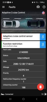

I have had a miss alignment fault after rolling into a wall at very low speed. I have been through some tutorials online on how to do the realignment. I have spent hours adjusting it, clearing the fault and resetting. The acc will work for around 3-4 miles and then stop, with the error again.
Does anyone have an idea if its possible to fix it or is it a recalibration needed.

  9. Position your laser beam emitting device on a tripod at the same height as the centre of your radar mirror, right in the middle of your perpendicular line.
  10. Switch on your laser and point it directly towards the centre of the radar mirror.
  11. Adjust your radar horizontal and vertical screws until you get your lazer beam to reflect perfectly back to the very centre of your laser beam source.
  12. Go for a test drive and enjoy your ACC.
  13. If ACC still doesn't work, get your alignment RESET in the BASIC SETTINGS of module 13.
