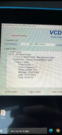

Recently 4motion stopped working and I got the error code c1113 07 plus a pump failure code.
I bought and fitted a new haldex pump and did the «pump motor» option in basic settings. One time it did say «finished correctly» but also says «time out» or something. But still no power to the rear wheels and error code comes back after a few kilometers.
Any suggestions where to look next?

Thanks. So you had obviously cleared the fault as there was none for 22-AWD in the log.
Nothing obvious in the blockmap. However, I guess you had handbrake on (as manual gearbox) and thus no Haldex engagement.
