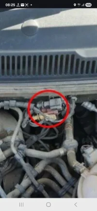

So Obviously I have to get it out of LIMP mode.
Question is the sensor is not avsilble in my Country atm. (BANK 1 Sensor 3).
Is my Sensor actually broken and this is just a coincidence?
Or is it "FOULED/DIRTY" and just needs cleaning?
Is a Dummy resistor/Plug etc available, that I can plug into the harness to trick it into thinking the Sensor is ok, so I can perform a "REGEN"?
Also is Bank 1 Sendor 3. This Brown one in the picture?
Thanks
