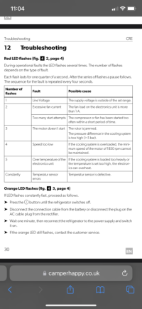

Edit, i see in the later comment that the orange light is flashing. The instructions say to turn off using the powers switch then disconnect (remove fuse or disconnect from battery) leave for one minute and reconnect.IMG_5785.png
I only bought the campervan 2 months ago but that was the first time it dropped below. It’s now dropped down and showing 13.9. I’ve attached a photo of the reading we are getting inside the van.
Do you know why our fridge is now not working and just constantly flashing orange and do you have any fixes for this? I’ve tried everything I’ve found online but nothing seems to have worked.

Without any sensible manual it's hard to tell what your charger is doing, but it is advertised as a reconditioning charger. So if it started to charge a very depleted battery it may well have tried to "recondition" it by holding the voltage higher than normal - though that voltage if accurate is still very high.
If the voltage has settled such that the battery seems charged I'd try the full disconnect reset a couple more times. And make sure it's a full disconnect not just the fridge switch looking at other folks threads.

Compressor fridges take a high current to start the compressor motor, which can cause a voltage drop that then trips either the battery protection or the motor jam protection. It's a good idea to make sure the fridge is wired as directly as possible to the battery with good quality high current cable to minimise that voltage drop - you'll still need to ensure it's fused and ideally switched.
Not something you can check or fix while camping but something you can do before deciding the fridge has failed.
