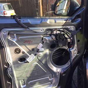

  3. LambethBoy
    removal: metal internal door skin / door assembly?
    How do I get this off guys!? I’ve taken out bolts but something is holding it there!
