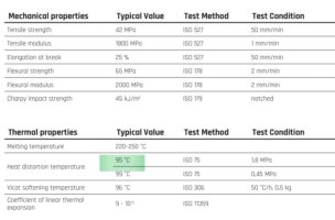

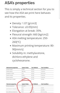

However being unfamiliar with the heat at the outlet (after the length of ducting) I have printed a batch in ASA which has the following properties:
Vicat Softening Temperature 106 °C
Heat Deflection Temperature 100 °C
Melting Temperature 210 °C
This is actually not too dissimilar to PC which is generally used by companies such as Webasto previously quoted.

Way to show it's not suitable yourself (#owngoal) air coming out of diesel heater is in excess of 100c.
Oldiebutgoodie just gave a great idea, protects you as well.
As for incorrect info.... Nope.
What you're quoting may be a different material mix to what I quoted doesn't make it wrong.
Perhaps you shouldn't be so quick to dismiss constructive feedback. 😉
No I linked to the specific filament I am using and heat at the outlet is dependant on the heater. Thanks for the constructive feedback. Now some for you, try and be happy and let people live their lives. stop trolling with silly hashtags and snarky comments.
I’ve said i’m happy with my product, I have sold and will continue to sell. I have already iterated and will continue to do so. There is nothing for you to win here.
We are letting people live their lives by protecting them from losing them from your poor judgement. It is quite simple - use a material that matches the manufacturers requirements for hot air outlets. I don't know why you are persisting in using sub-standard materials when you full well know what the requirements are - as delineated above.
