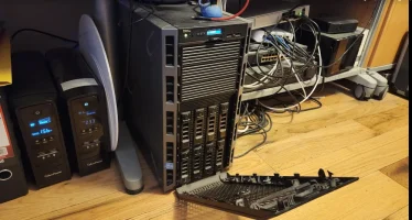

you mean these. . . ?
Home UPS with 3pin and IEC sockets. - 1500VA / 900w
they run the servers, switch, router, pc, screens. etc etc.
ives about 15mins to enable correct shutdown and power notifications to be sent out.
been running since 2018 & 2019
