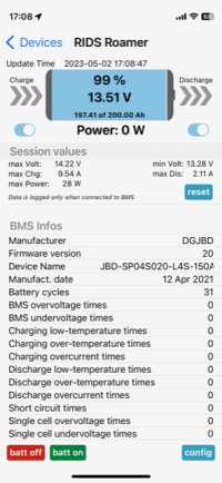

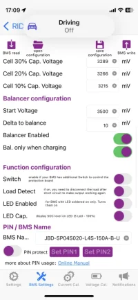

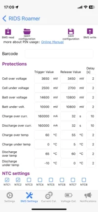

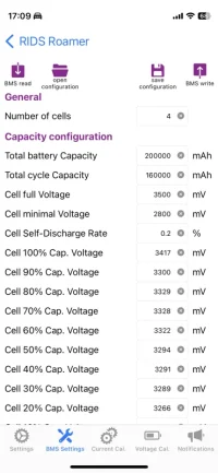

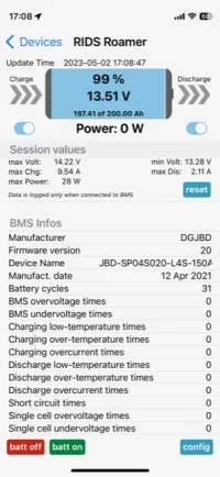

I don't suppose you happen to have screenshots of the bms settings?
I am sure that my settings are wrong! For a start the capacity is set at 180ah. I am sure it was sold as 200ah and I struggle getting the bms and the smart shunt to reflect the same figures.
I’ll check it this am. For a while mine said it had 110Ah. Steve at Roamer said it would self correct after a full discharge and re charge but that didn’t seem to work so in the end I paid for the app upgrade & then told it was 200… they seem to agree now.

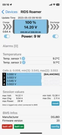

Whilst I'm on the blag! Can I also ask what sort of delta figure you get when your battery is on charge in the absorption stage of charge?
I still have to cap my absorption voltage at 13.8V as anything above this causes the delta to increase rapidly as cell 4 seems to increase and cell 3 decreases. This occurs when the absorption voltage is above 13.8V or so.
My battery has cycled over 60 times and I'm not 100% happy that the cells have ever been in balance.
I'm thinking that I just have a sketchy battery which I should possibly take up with Roamer.
Ok, it’s pretty full and solar is charging in absorption mode, the cells are balancing within the 10mv I had set.
I changed this to 5mV and sure enough it startled to pull them in.
