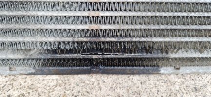

Just bit of info I e been having turbo underboost codes come up and flashing glow plug warning light
Stipped intercooler out after noticing damp patch on front pictures are of the rear when stripped out
Just might help others with issue
