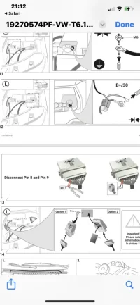

Just got the trailer harness for my t6.1 2012 . I am confused about the part in the instructions about cutting wire pin 8 and 9 from the trailer module why and why doesn’t it come prepared so I don’t have to cut wires kit number 19270574PF pj jones
First concern here is hopefully a typo on your part that wiring kit will not work with a 2012 vehicle.
You only cut the he red loop if coding is not possible or the additional features gained from coding the vehicle are not wanted.

From the instructions above it doesn't mention CUTTING wires, just disconnecting them.
When I did mine (between towbar prep wiring in D pillar to towbar connector) the instruction were to remove a couple of wires from one connector and put them in a diferent connector. My wiring was from Erich Jaeger though, so may not be the same as PJ Jones wiring.
