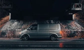

Currently van is on Bilstein B14s
275 35 20 With Judd T311R’s
The Bilsteins I think are at end of life and so do I keep them or go with solows?
Or Bilstein comforts also an option.
Let me know your thoughts? :-)

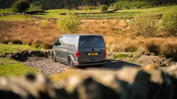

I think that if you are living within the country as seen in that top lovely image then keep drops down to within sensible limits or remain at normal height and with sensible rubber.
Guess it depends what kind of drop you are after
I don’t mind going a bit lower and so lows at their highest I think would be fine.
I don’t think I have ever been that sensible 😂
Yes I am countryside but regularly on the motorway to Glasgow and Edinburgh, the country roads are not bad you get the odd bone shaker and that top image is a drive as slow as possible one.
