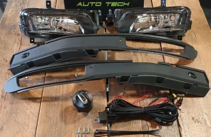

Can someone tell me, do the t6 fog lights fit directly onto the inserts that come with them or are they screwed onto something else? Cheers View attachment 324506

Just a word of warning though, I also purchased that kit and ended up having to replace the fog lights as they constantly filled up with moisture, I have also recently wired mine up the BCM, now they do all the correct cornering / turn functions, and in the end I could have probably just purchased all the parts cheaper individually rather than a kit, but that will be down to individual choice / skill etc

Simply use an acrylic sealant / adhesive around the shell / diffuser joint prior to fitting the lights, even if they are new, really crap design or manufacturing.
