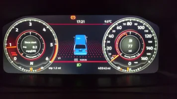

Show us a pic thenBig thanks to @antony.charnley for taking time out his evening to improve the quality of life in my faithful t5.1 with a digi dash install, coolant temp, battery voltage read out, range, mpg and much more all of which I didn't have before and all of which are appreciated.

What vehicle have you set the image as on your dash. Doesn’t look like a T6 from this shot.
