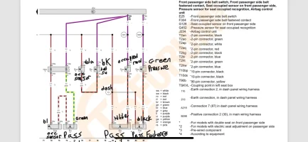

Heated seat or seat Occupency sensor maybe ?
Good shout but I think I can rule those out.
The black plug is obvious where to connect and is also the same on the same as the drivers side. My assumption is that this is the occupancy sensor.
The blue plug is passenger side only.
Heated seats weren’t fitted from factory and I have just added wiring loom for those as I have caravelle seats with heating setup already,
Does the seat have an airbag? (Ignore - they tend to have yellow connector plugs)
I think only the passenger seat has an occupancy sensor, so it can "arm" the airbags on that side. It would expect there will always be someone in the drivers seat. The only other sensor (on both sides) is the seat belt latched sensor.
I will double check again but I am pretty confident that the connector in question is only on the passenger side wiring harness.
Connector type does look very similar airbag but as @Paynewright states, these are normally yellow.
