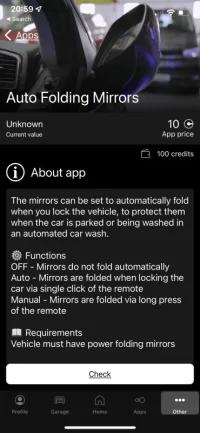

I have a t6.1 2022 with electric mirrors, however when I try to use this App I have a banner appearing saying that it is unsupported. No idea why. (And yes I have enough credits with OBDEleven as I bought the ultimate plan). Thank you for your help!

Hmm weird, which app version do you have?

I tried again today, and spoiler: I did manage to make the OBD11 "Auto Folding Mirrors" App work. Here is how I did it:
- I turned the ignition on (but not the engine)
- I ran a full backup -> no particular reason why I decided to do it but I thought that if I try things I might as well back up all the data so I can restore it if needed
- I opened the bonnet/hood -> some people say that this is necessary to modify the data
- I went into Apps->Auto Folding Mirrors and I turned the setting to "Auto" and clicked on the tick to write the data (you have to click and hold for some time, else you get an error banner saying "Hold to write value". The previous times I tried the drop-down was greyed out but this time it wasn't (not sure whether the backup or the bonnet being open helped)
And now it works, single short click to lock the car AND fold the mirrors (California 6.1 2022).
Before doing this I also noticed a feature of OBD11 in Control Units -> Central Electrics -> Adaptations. There, if you do a search for "spiegelverstellung" and click on the item, you end up in another menu with many options, one of them being the one mentioned above by folks using VCDS "spiegelverstellung...-modus". I believe that this "adaptation" does exactly what the "Auto Folding Mirrors" apps does although I haven't tried it myself.
I hope this is helpful to some of you!
