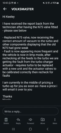

Yeah they were the last ones to have it. They replaced the n75 valve then said I need a bew turbo . I've had the turbo reconditioned and tested and I've since spoken to them and they are willing to retest for free but I have lost faith in anything now. I would out a bew turbo on if someone would guarantee that's what it needed and showed my why I need one but they initially said the n75 n then said that didn't fix it. And this is after a new
Egr . Actuator, turbo recon , manifold pressure sensor and the n75. I mean what on earth could be wrong

I assume they actually measured the vacuum when they changed the parts like the N75?
Who recon'd the turbo and what warranty is on it? Have you told volkmaster it's just been replaced ?
Tait turbos. They have offered to recheck it, I just need to get it all bk off as they don't do that side. Yes told volksmaster and they claim they have never used reconditioned before and for me to get a new
In fairness if he's been asked to fit a turbo then he's not gonna notice much . Did he calibrate it and check for faults do you know?
Or simply delete existing fault codes ?
I was told the Turbo reconditioned place calibrate whist on the bench does it need doing again while on the van
As @JumpShip said, the turbo should be under warranty and they should be able to advise if it needs calibration or setting up. Can you feel any play in the shaft?
