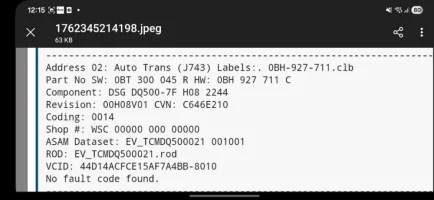

HELP! So.... I found my mechatronic cover plate badly corroded.
I bought a new one to replace it with and drained the oil. On removal of the cover, managed to snap the mechatronic TCU plug connector off. I've had it soldered back on but no connection on VCDS!.
I'm trying to source a replacement TCU.
The scan is here from before I broken the connector. Anyone with info, advice, spare TCU?
Help would be greatly appreciated.
