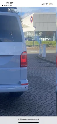

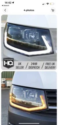

Just got a 66 plate T6 and it has standard front and rear lights. Can I just swap them out with led ones? like the bottom two pictures Or is there more to it than that?

The front lights are a bumper off job though. Which is a couple hour job from what I’ve read on here so that will be done over Xmas period.

This is correct - you will just need to get the fronts aligned afterwards
