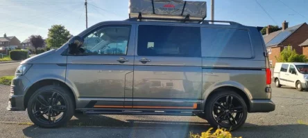

Hi All, we have a 2016 T6 t30 150bhp new fuel system completly in 2018 under warranty, new full egr, pipes & cooler in 2021 and we have just had the following issues at 113k. Worried as set to go to France later this month.20250802_185208.webp
1, topped add blue - showing 4500 miles.
2, 1 day later filled up with Esso premium deisel.
3, Same day had P20EE error code this reset itself on next start up.
4, 1 day later after 50min run up motorway the add blue dropped from 4500 miles to 650 miles warning & it then reset to 4500 miles 10 minutes later.
