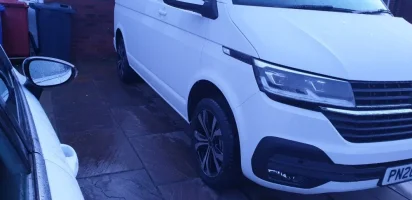

I've just purchased a set from wheelbase to go on a T6.1 on Monday, will post pics when i get them on. Very hefty and appear well made.

Very nice shame about the arch gaps
Agree, I will have to leave them like that for now. Too much needs to be spent on the camper conversion at the moment. One thing I have noticed is the pressure sensor warning light has illuminated and I am baffled as to how I reset it. The manual does state that sensors are in the wheels (but not in my supermetal),so maybe I will have to live with the light??
