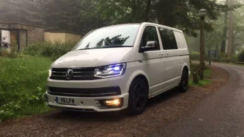

As above, Is it possible to fit a Sportline Splitter on Startline Bumper?
I realise there will be a fair amount of body work.
I have a good friend who has a top notch body shop. I'm hoping it's possible without buying a new highline bumper.
Below is what I have, and what I would like to achieve!

The problem @M444TCC is that you have a Start line combination one-piece grille and bumper and you will need to change the whole thing as far as I'm aware. Others may know different but afairc that's the situation from a previous thread.

I've been speak to a few people, from what I can gather it's perfectly possible.
But it's looking to be less cost effective, than buying an already painted bumper.

There cant be much difference in the 2 bumpers as the metal work that it all fits to is the same. A smooth bumper and grilles can be had new for just over £500 from the likes of TPS, these are genuine parts. With a few coats of high build primer and lots of rubbing down the textured bumper can be made to look the same, you just need a friendly paint shop. Fitting a bumper is not hard, just lots of Torx screws.

Be careful doing it this way, the thicker the primer the more likely it is to crack or flake.. Your better off sanding off the bumpy surface.. Tis is because you can't really degrease or prep the bottom of the dimple properly, thus giving a poor keying or adhesion area for the paint (even 2k....
I have my own ways that I keep to myself of painting this type, or most other types of plastic bumpers, that are guaranteed not to peel and flake.. And I do not use plastic primer either..
