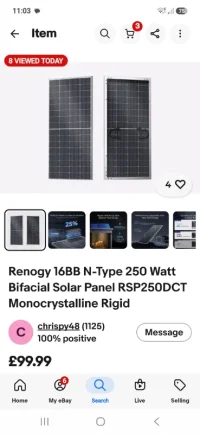

Having no experience at all with solar, will this panel suit an Ecoflow Delta max 2? Or put it another way, will the Ecoflow handle the panel? Cheers.
You need to look at the details on that solar panel and find the voc or voltage open circuit.... For example it could be 19.5 volts or if domestic it could be 40.6 volts.
Then look up the spec for the eco flow delta 2 Max and check the solar input... It will give you the voc max rating for example 50 volts...
As long as the solar panel voc is under the maximum import voc of the delta 2 you are good to go..... Don't worry about the ISC or current as that's normally always limited to 10 amps..... It's the voc value that's important.

The panel is 29.6VOC and the EF is 11 to 60v per port...so i assume im well inside the parameters. Cheers.

yep...
there you go, and instead of me saying just yes - it will work.
you learnt something new and sussed it out yourself. --- top bannana
