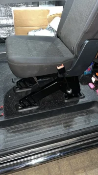

Due to a third row of singles behind these for the van king bed system and to use with the second row out i had a problem
The osr third row seat could not be tilted to get in or out..i use as a lay across the seats when parked up and also use the middle and left properly for the kids, so i set about modding the thing!!
Tested fitment in easier position for now (vans full a crap from the conversion

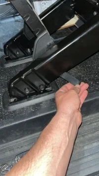

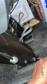

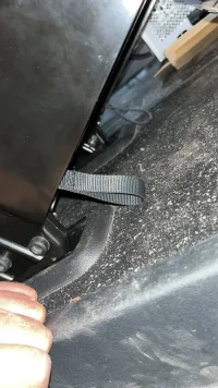

Used the rear clips from another seat on front of seat to enable push down to clip in, release tabs to get her out
Love it when you think about something and then sort it!
