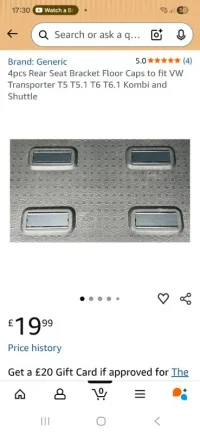

Yeah.. we used those, then a rug/Matt on top.
