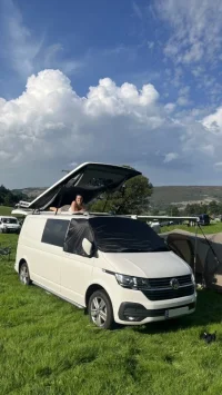

We have a pop top which is for head height - no bed board as we don't plan to use it for sleeping.
However, we did get a scenic canvas fitted, and wondered if anyone has any ideas for putting a small board across to act as a seat?

We have a panoramic roof, and I wasn’t sure how much I would bother fully opening it. Then we had a very sunny day at Llangollen, and daughter was very happy using the bed as a sun deck.
So yes, you can use a bit of 18mm ply, I would advise a rib across it to stiffen it where you climb on.
Advantage of not having lift up bed is more headroom with poptop closed.
